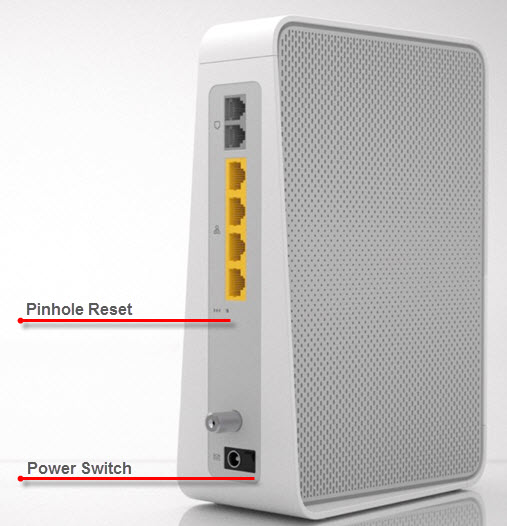

On the Virgin website I can choose from 4 modems.
I thought you were referring to the Super Hub below
