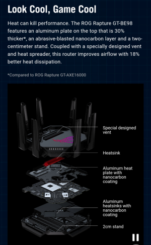

This could be true, but after I saw ASUS advertise that the BE98 has 18% better heat dissipation, I started to think that Broadcom might still be using 16nm.
It should be pretty easy to find out if we can monitor the temperature of the CPU for both models. The BCM4916 is a Quad B53 at 2.6GHz, while the BCM4912 is a Quad B53 at 2GHz; that’s a 30% increase.
Let’s assume that the power consumption/temperature has a linear relationship with frequency (I know it’s not exactly that). Combined with 18% better heat dissipation, if Broadcom still on the 16nm node, the CPU temperature would definitely be higher than that of the BCM4912. If Broadcom moved onto the 12nm node, then the CPU temperature could potentially be lower or at the same level as the BCM4912.
Oh, I also emailed Broadcom and asked them about this, but they didn’t want to disclose any information other than what’s on their website.
