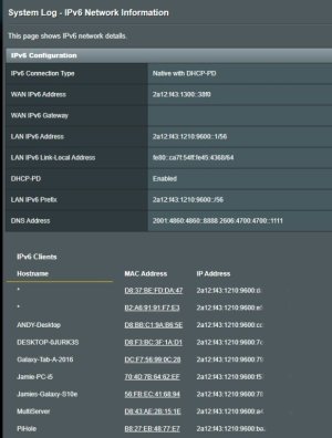

I am running latest merlin on Asus rt-86u-pro.
I have global ipv6 address to my devices but unable to access internet over ipv6, ipv4 is ok and works as normal.
I have changed ISP today to one who uses a ipv6 network as standard and I have also paid for a ip4 address as they use cg-nat. The devices on my network get a global ipv6 address yet none can communicate to the internet using ipv6. Wan is set to connect with automatic ip and the ipv6 to connect using native. I get a /56 prefix from the isp. I have minimum experience with ipv6 and my isp will not give support to anything but their router. Pictures attached of my settings. I hope that someone with ipv6 experience can point to where I am going wrong. Thanks in advance.

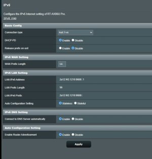

Try using a /64 instead of a /56.

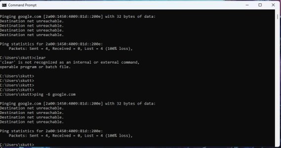

If I try to ping google.com using ping -6 google.com, I get host unreachable.

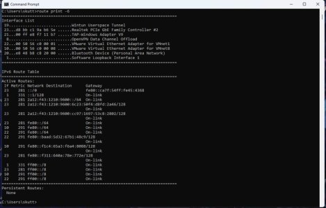

Look at your IPv6 routes on both the router (System Log / Routes) and on a client (route print -6).
Does this make any sense to you?
The default route is to your router, so that’s good. Can you ping over IPv6 from the router itself?
If you have Entware installed, install tcpdump to watch the IPv6 router advertisements on WAN and LAN interfaces. dnsmasq will only advertise a /64 to the LAN, even if you’re delegated a /56.

Still get host unreachable error. I am thinking this is a routing error within the asus router as if I use the isp router it passed the tests on test-ipv6.com and I can ping ipv6 addresses. But alas the isp router sucks as it is locked down and many options are missing.
As @dave14305 has suggested above, could you try pinging over IPv6 from the router itself, rather than the PC. While we can see that the PC has been allocated an IPv6 address and route print -6 appears normal, it is not clear whether the problem lies between the router and the internet (via your ISP) or between the router and the devices on your LAN, though the former seems more likely.

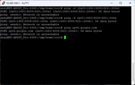

Hi, mac address is already cloned to the isp router mac address. Ping fails on the router. So I assume this is a routing fault?
It definitely looks that way. If you try running traceroute to ipv6.google.com under IPv6 from network tools - how far does it get?

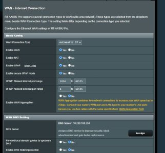

Also as mentioned by @bluepoint , the WAN DNS is showing a private ip block (10.200.100.250). Is this a result of accepting "Get the DNS IP from your ISP automatically", or is this a setting you have added, and if so what is the reason?

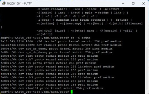

Yes, there’s no default route on the router. Seeing tcpdumps on the WAN interface would help explain if the router lifetime from the ISP is valid (non-zero).

traceroute fails with network is unreachable error.

The 10.100.200.250 address is my pihole which returns both ipv4 & ipv6 addresses correctly when queried, given time it's link local address also appears (fe80: etc)
Surely no gateway means no internet? Maybe we should look at why there's no assigned gateway for IPv6?
(first screenshot, first post)
