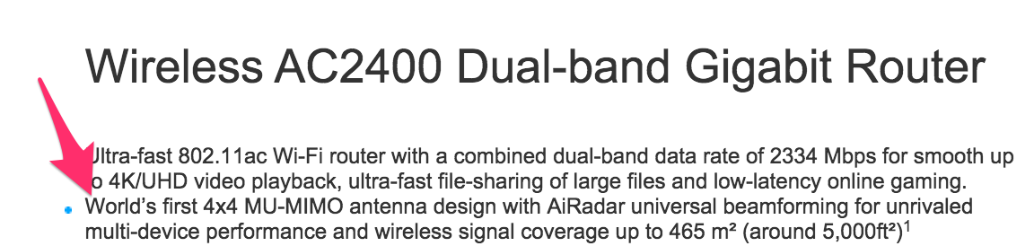

Taken right from their website, front page for the product:
They have it somewhere in a footnote, in the small-print that this will only be enabled later.

Sheesh. The RT-AC87U is a "4x4 MU-MIMO" design. Nothing untrue about that.
Also nothing untrue about the fact that there currently exist no 4x4 MU-MIMO clients as of March 7, 2015.
