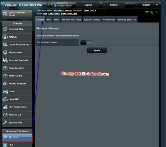

I am using AX11000Pro. Recently, I found out the wireless page has only one option for Smart Connect, nothing else. It used to be those settings for 2.4, 5g1, 5g2. Where can I find that, and is this an issue?
Issue solved, when i turned on the Ethernet Backhaul. The detailed parameter came back available now. I am using AImesh, before this toggled on, i used auto for backhaul (wireless and wired depending on systems).

Try a different browser as a test as I think you have a cache issue.
It is solved now. I tested on different PC and even on my mobile. It showed the same. It is nothing to do with a cache. See my main post, i updated there how it got back again. I would believe it is an vaild issue. But still need to get more clues and more users with the AX11000 PRO
