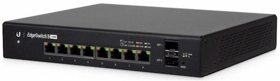

Ubiquiti's Ubiquiti EdgeSwitch 8 150W is a powerful managed switch that can be challenging to configure
Read on SmallNetBuilder
Nice unit - overkill for the home network, and perhaps even a small office (although it would work well in a small office) - medium size business or hospitality (think hotels), this is a nice unit.
Yes, a bit of a learning curve, but once there - there's a tremendous amount of flexibility - a lot of stuff inside a $200USD box...
