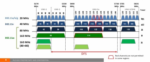

Well I can already say that when you choose the 160Mhz option on some devices the UI is not even allowing you to independently choose a control channel option when you set it 80+80 MHz or the 160 MHz frequency. But w/ that said I thought the whole thing w/ these new routers (and this new chipset) is that i didn't need an analyzer or channel to get best signal. It just seems counter productive to encourage ppl (that are trying to save money) to buy in-house equipment which already inherently produced to underperform.
According to my understanding from Apples Technical Wifi Specs the latest model MacBook Pros will only bond to two 80 Mhz channels. They don't support 160 Mhz. Does anyone know of any wifi boxes that have multiple 5 ghz 80 Mhz channels? Any mesh units?
Bonding 2 x 80mhz = 160mhz right?
Google 160mhz router or go with an AP that does 160mhz. It mostly comes down to budget and which version whether AC AX AX-E.
I have an AP that does 160 and AX and they run $150.
Nope...
They support 80/40/20 MHz channels in 11ac/11ax modes - no 160MHz support of any kind...
