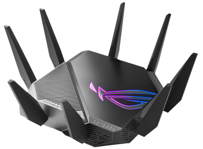

We're taking a look at whether Wi-Fi 6E is worth waiting for, using ASUS' first-to-market top-of-line GT-AXE11000 ROG Rapture.
