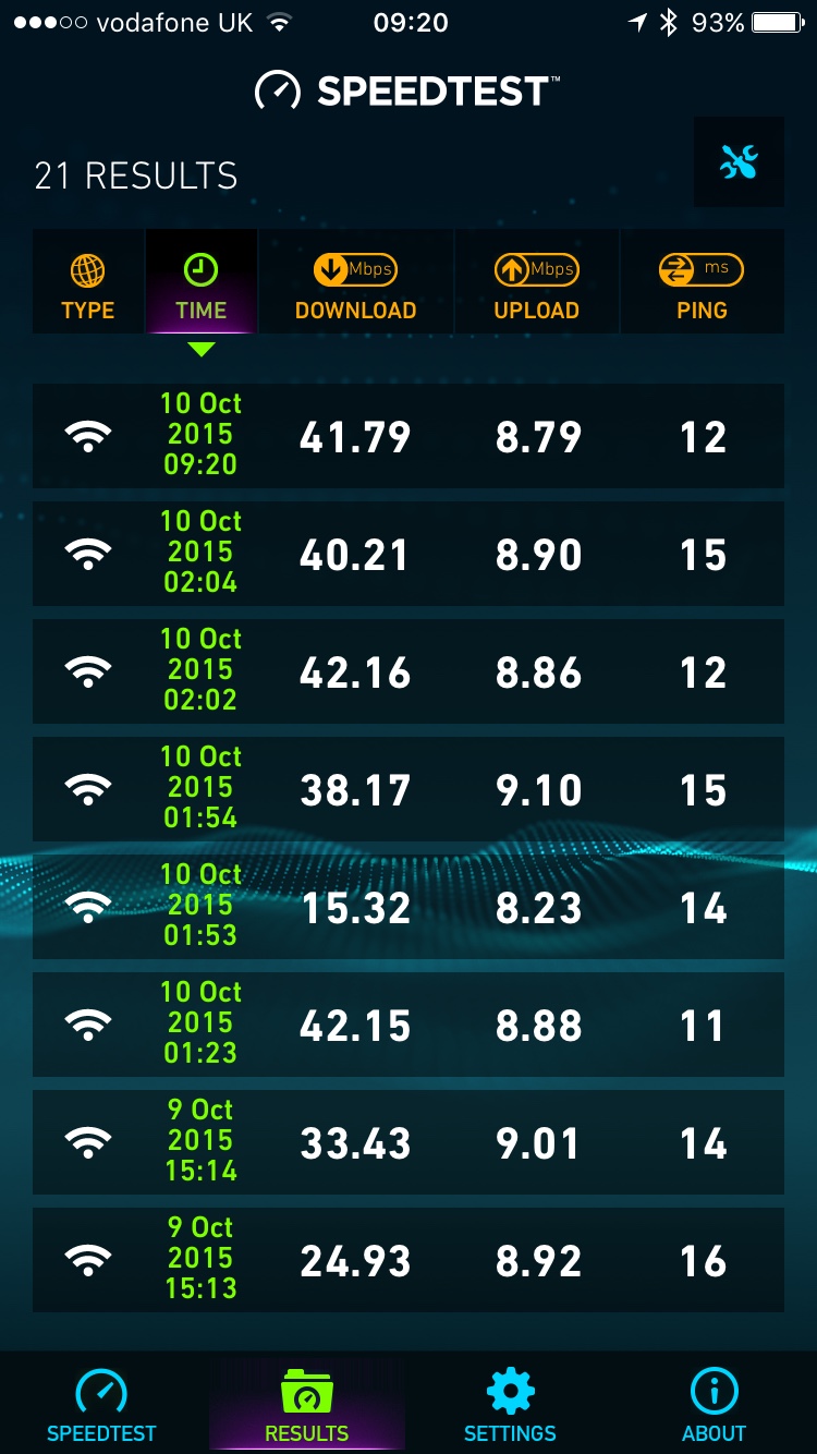

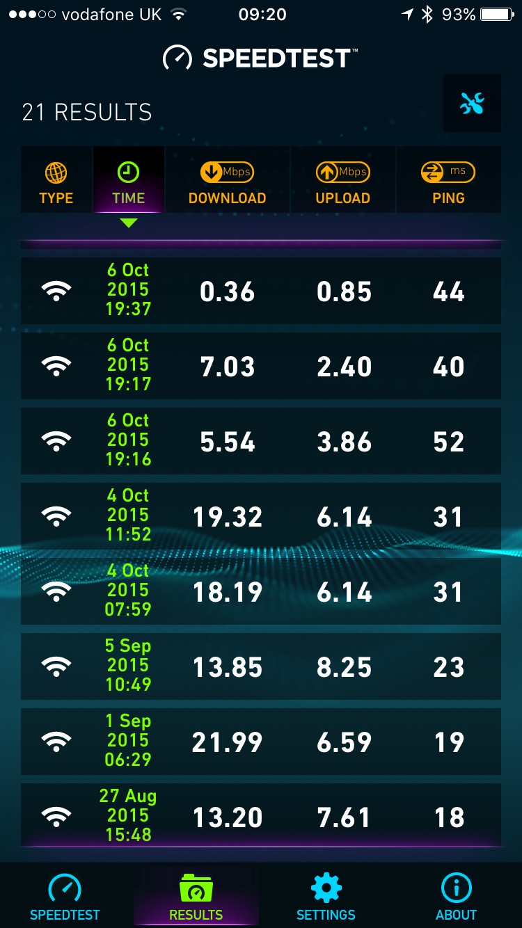

I did use the homeplug to move the Asus to the centre of the house with excellent effect.
Before:
After:
Last 2 results are from the 2 rooms that used to struggle to even get a signal. Oh my connection to ISP is 44 down and 9up. So I'm thrilled with the result.
Even better so far it looks like I can get 5Ghtz throughout the house. Will know better over the coming days.
