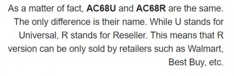

additional two AC68U's AiMesh nodes (one was AC1900 and the other one is AC68R)

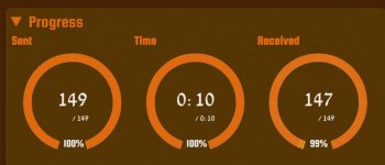

BUT
it seems like when I turn on Ethernet Backhaul Mode, I get a packet loss, but when I turn it off, the connection is good!

hey again... I really don't know what to do about it... the problem is still occurring. tons of packet losses, both using LAN cables and WiFi.
no matter how I connect to AiMesh nodes, it comes out faulty.
when I'm connected to the main unit the connection is perfect.
I've checked the cables that go into the nodes and they are perfect. I'm getting 0 packet loss and 100% speed when connecting them directly to my laptop. when I plug the cable to the Node's WAN socket, and connecting my laptop to ext1-4, the connection is faulty again, also using WiFi.
pleeease advise i really dont know how to solve it and I can't use the internet like this...

hey again... I really dont know what to do about it... the problem is still occur. tons of packet losses, both using LAN cables and WiFi.
when I'm connected to main unit the connection is perfect.

sure , a few times already... also tried different firmwares on the nodes, restting and reinserting as an AiMesh node, nothing helps... the result is always the same.
I wonder if there's a way to check those ac68u's hardware somehow ....
So, if only one AC68U node connected, no matter which one, you lose packets?
OE
exactly. and only when I'm connected to the nodes.

it's not dropping when the node is in AP or Router mode...
only when it is in a Mesh it comes out faulty....

AC68R is not supported?? it's the same as AC68U. it's not hacked.

I think you got it wrong... nothing is hacked here. I've told you that this is an ac68r using the latest firmware without hacking anything.
You probably failed to read line 3 on my first post explaining I was using AC1900 + AC68R.
You just don't know how to solve it so you throw that on me, it's easier I guess.
