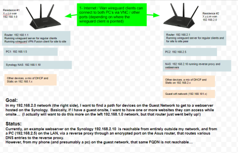

See attached for a basic diagram, and also most of the setup of my issue.
I have two homes where I'm implementing roughly the same network, and then a peer to peer wireguard between them.
In one I have 192.168.1.x and in the other, 192.168.2.x.
I have a synology NAS with a reverse proxy behind my AX88u routers in both locations.
In both locations, I have a guest wifi network as well as the 'regular' wifi, and the guest network is set to 'no intranet'.
However, I would like to be able to open a website on the NAS ONLY to my guest network (i.e., not to the outside world).
Here's a simpler thought then- while I want to use my guest network for guests, I also want to let them access a single locally hosted webserver on my internal network, ideally through my synology reverse proxy.
I'm about there now in the sense that all the reverse proxy stuff is good to go, but only from the non guest network. If I try to traceroute from the guest network to my public IP via its DNS name, it goes nowhere, even though it sees my router's public address when it does the DNS lookup... So the guest network is I guess not allowed to go 'out and back' through the front door as I'd like?
