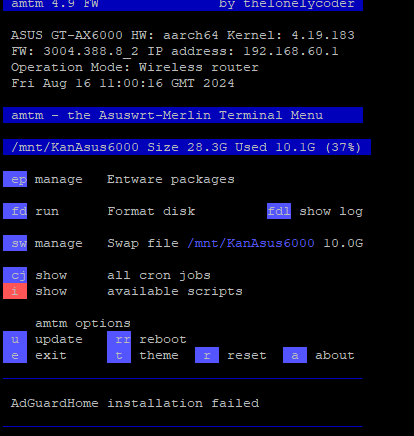

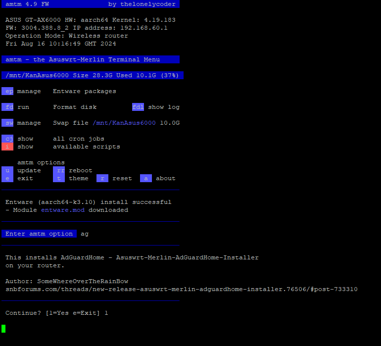

So, I have 2 Asus GT-AX6000 routers at home (1 as mesh client), I was having an issue with AMTM being too slow when using the check for Update function.
So I deviced to do a factory reset, and setup/install everything from scratch, but I'm having an issue when trying to install AdGuardHome via AMTM.
I select the AG option and stays on this screen for like 30 minutes
after that, I get this message
I already tried with a new USB stick, but still the same.
Any assistance is appreciated.

I swap the routers, the one used as AiMesh client was setup as primary one, New USB stick. Everything install fine (Skynet, FlexQos, YazFi, Entware, Scribe) but AdGuardHome don't, showing the same behaviour.
I'm using the latest firmware on both routers 3004.388.8_2, AMTM 4.9
If I open that link on a laptop connected to the router having the issue, I'm able to reach it.
From the router I can ping and get that, but still AMTM is hanging when trying to install AdGuardHome
Instead of wget, try curl -v
I get this (pasting the first 2 and the last screen as there are a lot)
Looks good. Does the update check in amtm work?
it is kind of slow, but working. Let me update to 4.9.1
updated to 4.9.1 but still stuck at AdGuardHome install
Run ps ww from a second SSH session while the first session appears “hung”. Post the results.
Also make sure you can reach https://api.github.com/repos/AdguardTeam/AdGuardHome/releases from your network.

Great! Run:
curl -L https://api.github.com/repos/AdguardTeam/AdGuardHome/releases | sed -n '/"prerelease": false,/q;p' | tail -4 | grep "tag_name" | cut -d \" -f 4
It seems to be caught in the until loop at the beginning of the script. I believe if you leave it for a few minutes it will continue.
after about 30 minutes, I got this
Ok, please run:
time curl -Lv https://api.github.com/repos/AdguardTeam/AdGuardHome/releases -o /dev/null
ping api.github.com
Also, since you run Skynet, try to whitelist api.github.com in case it’s being blocked.
