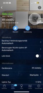

Set up in the study and everything ran:

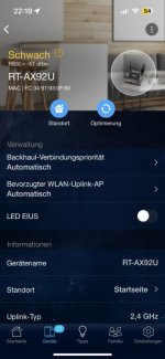

Since the second day it gives me only problems, the backhaul connection keeps falling back to 2.4 GHz.

Since then I have tried the following:
- Updating firmware on 92U and 86U.
- Install Merlin on 86U (Interestingly, the 92U could only be connected via a lan cable for the initial setup).
- installing older firmware on both devices.
- Merging of the networks 2,4 and 5GhZ
- disconnecting the networks
- Deactivation of WWM APSD & Roaming Assistant in 5GhZ
Whenever I thought I found a solution, since the mesh was running on 5GhZ again after a reboot it dropped back to 2.4 GhZ after some time.
