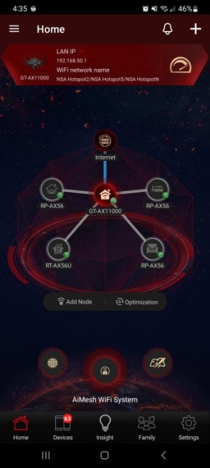

Hey all,
Sometime this morning I had all of my aimesh nodes drop off. I have 3x RP-AX56 on wifi backhaul and 1x RT-AX56U hard wired via 50ft ethernet cable. I have restarted the router. Nothing. I then restarted the nodes and they all reconnect but only for a limited time and then disconnect again. I am running the 3.0.0.4.388_22525 firmware. I am trying to avoid a factory reset of everything if possible....
Current setup in screenshot below
Looks like you are affected by this issue: https://www.snbforums.com/threads/r...mory-leak-leads-to-lockup-every-10mins.85018/. I also have RT-AX56U that does not currently work due to this issue. You can flash Merlin, this solves the issue, at least for now.
It fixes the RT-AX56U - is there anything that can be done for the RP-AX56U access points? I have a couple and had to ssh in and SIGSTOP the asd process and then hope they don't reboot. Hoping for a more sticky solution.
