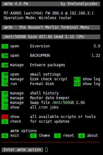

amtm 4.0 is now available
This major update includes features previously only available in Diversion:
- amtm header shows Entware device and usage
- Additional checks are made during Entware install
- Cron jobs can now be viewed in amtm with cj
Additionally, these features were added:
- Shows separator for what amtm considers third-party and non third-party scripts on the i install screen
- Reset/Remove r option shows more info when selected
- Added --crlf carriage return line to test mail function, thanks to @Cedarhillguy for reporting
- A few minor fixes
And last but not least, I'm very pleased to announce:
- Adds support for BACKUPMON - Backup/Restore your Router, by @Viktor Jaep
- Adds support for Domain-based VPN Routing, by @Ranger802004
How to update amtm
Use u to update to this latest version.
