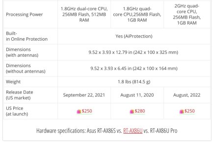

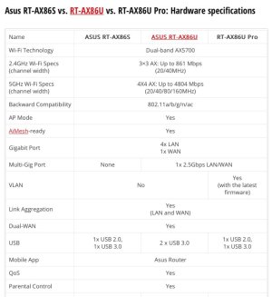

I have to credit dongknows for this table (no affiliation) which gives a simple set of differences. Apart from the CPU and VLANs via 3.0.0.6.102 FW, not a lot of difference.
Lots of previous discussions on these models though.

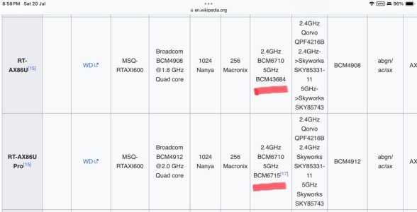

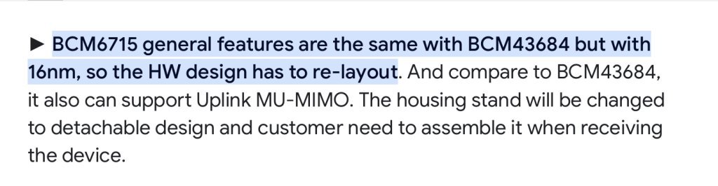

Thank you OE, you prompted me to look a bit more closely at the radios and you are correct they are indeed different, for the 5GHz radio at least.
The wikipedia entry shows the non-Pro vs Pro having Wifi radios using these Broadcom chips respectively:
I had a wee look at Broadcom's site for the specs but it’s over my head as to what the specs mean. There’s a couple of summaries attached from a Google search for the differences, which I found interesting.
And it’s not just the CPU that is clocked faster (as I had thought), it’s actually a different chip too, with (apparently) better power usage:
  • Broadcom BCM4908 @1.8 GHz Quad core
  • Broadcom BCM4912 @2.0 GHz Quad core
Oddly there’s no entry on the Broadcom website for the BCM4908, that I could find. This forum has a discussion on the merits of each chip here.
I’m not sure if this level of technical detail was what the OP was after, or just a performance summary, but interesting stuff all the same, thanks!
