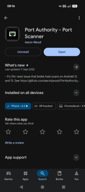

If you have an android device install Port Authority. Scan your network for devices then, if found, scan the well known ports on your router.
Almost sounds like there's a second dhcp server on your network.
Are you sure of the name "Port Authority"? I am on Samsung Galaxy 24 and cant find anything with that name in play store.
It's still there
