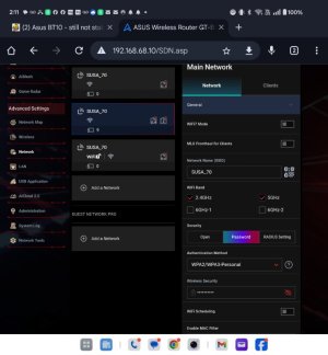

- Main (2.4Ghz, 5Ghz & 6Ghz band enabled), Wifi 7 mode, WPA2/WPA3-Personal Auth, MLO disabled, Mac Filter - Reject enable (to prevent some too-smart-for-their-own-good IoTs to connecting to the Main)
- IoT (2.4Ghz, 5Ghz band enabled), Wifi 7 Disabled, WPA2-Personal Auth, No Mac filtering
However currently - because of the instabilities, I have a single Wifi network unabled (Main with 2.4, 5 & 6Ghz band, Wifi-7 mode, WPA2/WPA3-Personal Auth and no mac filtering), which is what yield the most stable situation (even though it is far from perfect).

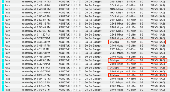

And to a lesser extent the 5Ghz seems to be impacted as well, I have been installing a wifi monitor (Wifi Signal: Strength Analyzer) that is continuously checking the strength of the connection, and it's showing random drops (bandwidth down to 0 Mbps semi-randomly) - see attachment for details. I have been monitoring for days over many different configurations, some a more stable than others (like for instance turning on Wifi-7 mode on a single network helps a LOT but it has a drawback because for some reason, my Flair Puck for the smart vent system cannot connect to the wifi on Wifi7 mode - I am assuming some Auth issue), nut none are perfect.
