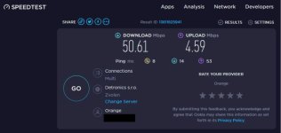

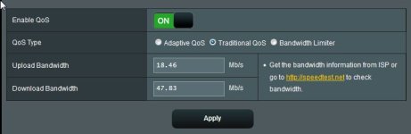

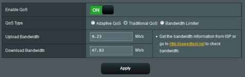

Basically, after setting the QOS upload bandwidth to 95 % of the provider's nominal value (we have a 50/10 Mb/s connection), the effective upload speed is approximately halved for all connected clients (workstations and mobile phones.). After doubling the upload bandwidth, the effective upload speed is alright. For instance:
- if I set 9.23 Mb/s as the upload bandwidth ("QOS - Normal upload bandwidth.jpg"), then the effective tested upload speed for client is approximately 4.59 Mb/s (halved give or take - "Speed test (workstation) - Halved upload speed.jpg") and the upload speed for the router is also significantly low although not halved (6.07 Mb/s);

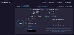

- if I set 18.46 Mb/s as the upload bandwidth ("QOS - Doubled upload bandwidth.jpg"), then the effective tested upload speed for client is approximately 9.16 Mb/s ("Speed test (workstation) - Normal upload speed.jpg") and the upload speed for the router is also normal (9.86 Mb/s).
