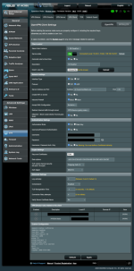

I've had no issues with my OpenVPN settings with various devices but now have one with my new NVIDIA Shield Pro where the connection just drops.
I've attached a screenshot of the traffic analyzer page which shows it dropping then shooting back up.
I'm sure the issue is on the NVIDIA end but there's not much I change in the device settings and was wondering whether there's something I can do on the Merlin side.
No matter what I'm streaming, the connection just drops every 10 minutes or so, below is how it looks in the log;

I've attached a screenshot of my VPN settings
