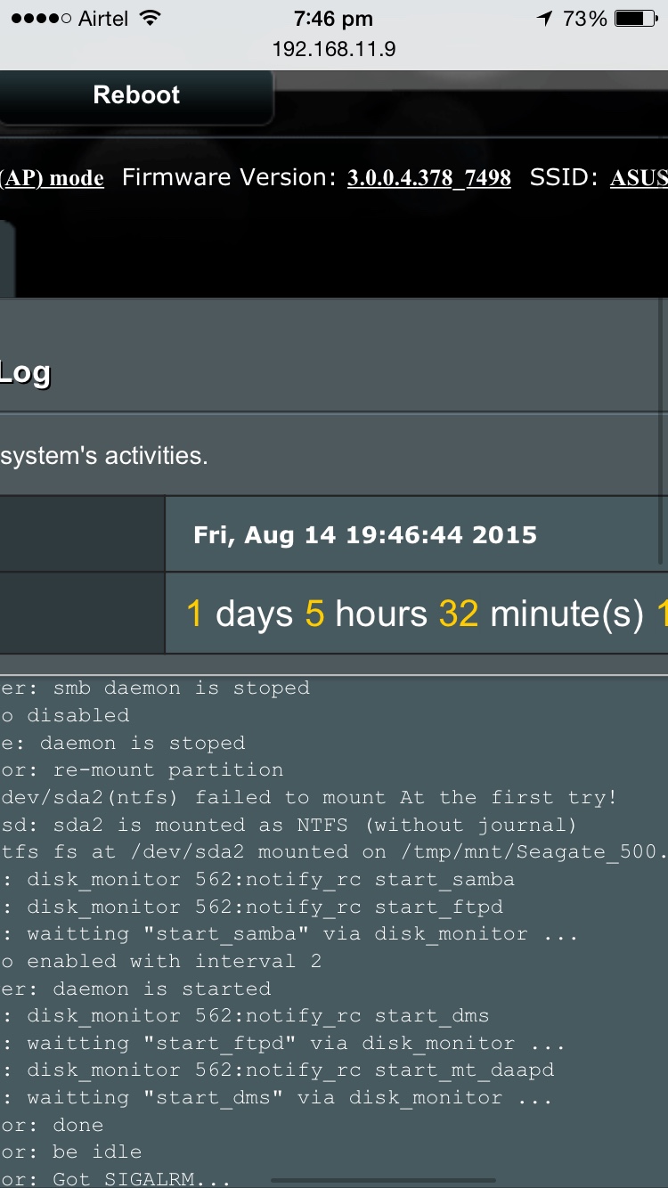

Some news for you. Please check the picture. With USB attached uptime has been about 19 hours. I haven't enable anything but media server and samba. Please take note of the latest firmware I'm using.
