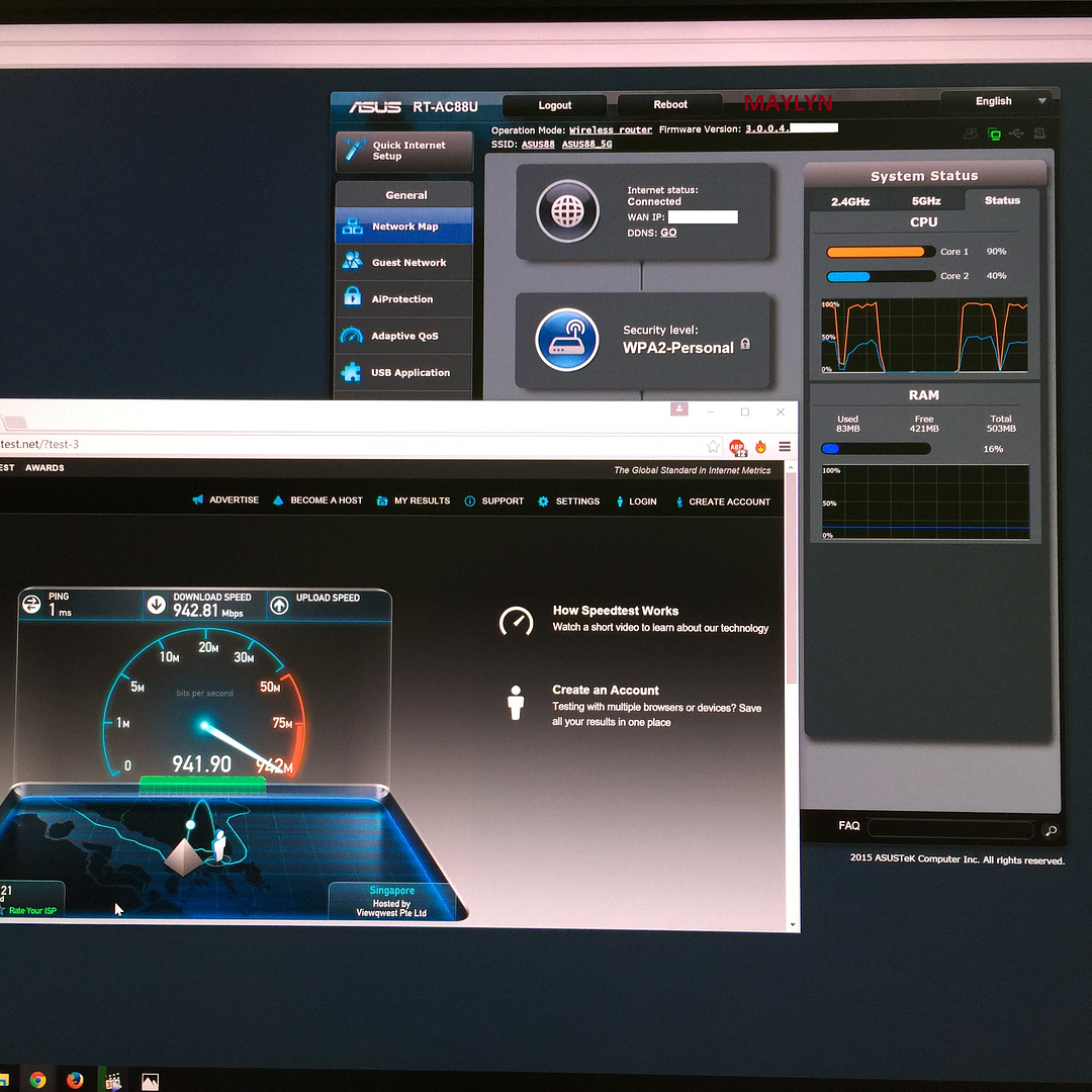

942.81 down, 941.90 up. Close enough. Even if that isn't concurrent speeds.
That's pretty good considering overhead...
Yes, very good for a mere consumer product, even at these elevated prices vs the previous router generations.
Some fiber technologies that are marketed as gigabit are truly 940 Mbps. This is the case with Bell's FiberOp for instance, which is actually 940 Mbps / 100 Mbps. I suspect that's the case with Viewquest's service. So the bottleneck is most likely not the router, but the service.
