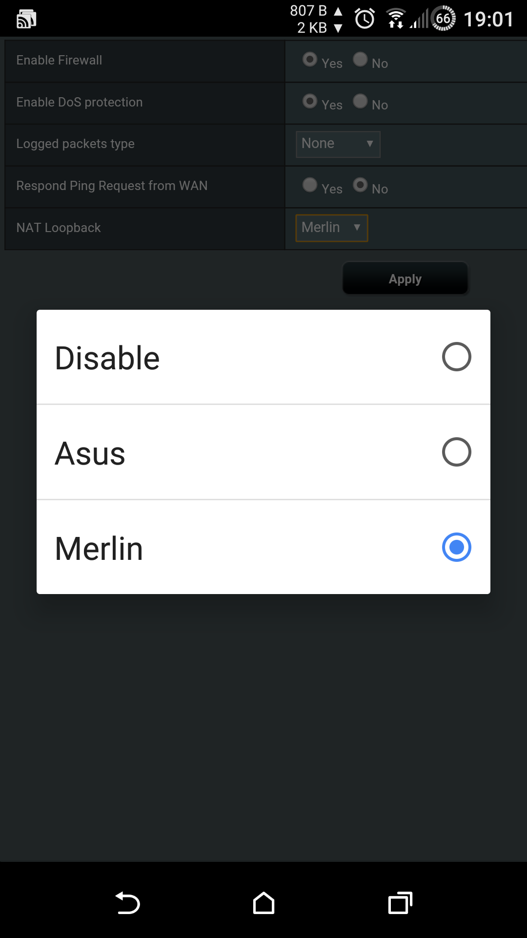

Thanks just giving that a go now. It was on Asus, changed to Merlin and I'm just rebooting it.
