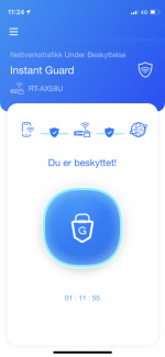

Text in attached photo:
In the photo "Du er besktyttet!" means "You are protected". It's norwegian
