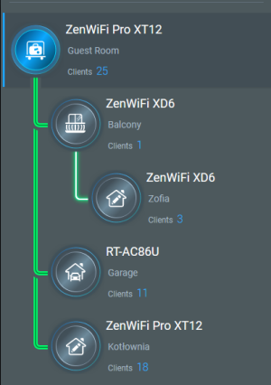

I have AC86u connected to XT12 wired and all clients connected to XT12 can benefit from wifi6. So network will not downgrade, only clients connected to ac86u will have slower wifi.

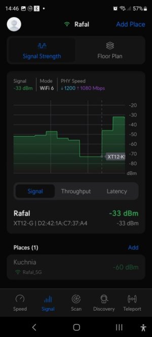

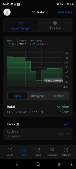

Roaming is also working. As you can see on screenshots, wifi changes from wifi 5 to wifi 6. I'm using this setup for about 6 months and no problems. Why ac86u? I bought 2 pack xd6 in promotion on amazon.pl for about 120$. It has wifi 6 and as aimesh node doesn't need a powerful cpu.
