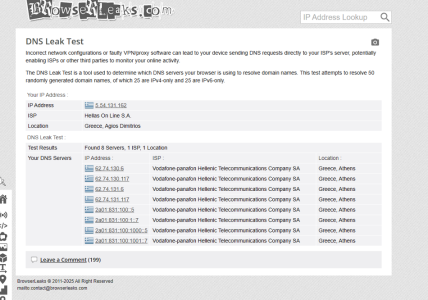

Any DNS settings on the router page do not take any effect at all, and when checking my DNS on websites online I do see my ISPs DNS as expected.

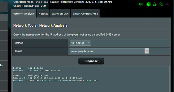

The nslookup above is from my pc, nslookup from the network tools on the router page works fine as it uses my ISPs router dns

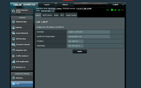

here

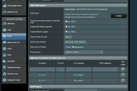

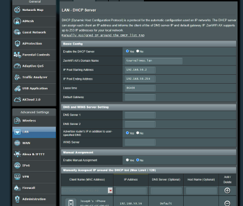

Enable DNS Privacy Protocol in WAN settings page, select Strict, select Google 8.8.8.8 and 8.8.4.4 servers from the drop down menu, don't forget Apply at the bottom of the page. There are other preset choices there for free public DNS services. Try again.

What is this test showing for DNS servers?

Well nothing that a restore cant fix.. Assigning DNS in wan settings still doesnt work, but your DNS privacy setting suggestion did the trick. Can you explain why it only works this way in my case?
Some ISPs have the practice to intercept and redirect DNS standard non-encrypted queries on port 53 to own DNS servers. Perhaps the case with yours. When you encrypt the queries and use different 853 port it goes through to the upstream public DNS servers you prefer. If the ISP wants to they can still prevent this from happening, at least for DoT.
