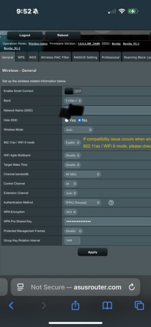

I was referring to
Parental controls …off
AI Protection…off
Adaptive QoS ….off
Traffic analyses …off
I attached a picture of my settings for 5G-1
I will be happy to share any settings that you need to be able to help diagnose. I just don’t know which ones you need. I know very little about this stuff, it’s just worked like it was supposed to before the move

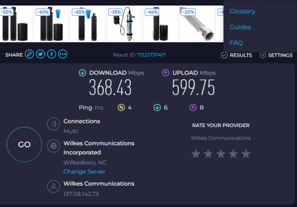

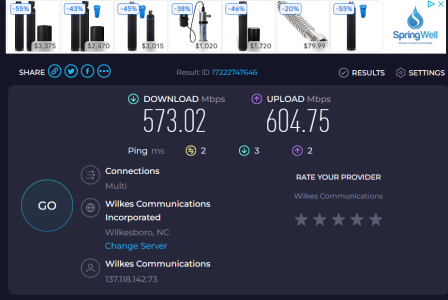

Ok hard reset the router and didnt change any settings at all. It ask me to bind or unbind my apple account for remote access and chose bind
here are the results 1 wired and one unwired 2' from router and all nodes turned off.
it was a slight improvement....but only slight

What client device are you using for testing the WIFI download ?
Is this the same client device as was used at the old house ?
