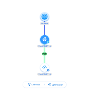

So I picked up this router from Amazon because there was a price drop of 200 dollars. I am coming from a Google Nest Pro Mesh unit that was pretty much plug and play I know very little about networks as well( willing.to learn though).
I have the router set up with the main unit in the basement and the satellite set up on the 1st level. One thing I don't understand is why all the devices are connecting to the basement unit, both on the first floor and the second floor. The devices in the same room as a satellite are still connecting to the basement unit. The satellite unit according to the app has a great signal as well.
I've already had to reset the router once because of some settings I tinkered with caused lots of problems so I'm trying to do this very slowly and deliberately.
Any help would be appreciated. I have 30 days to return this thing so I want to find out if it's going to be workable for me. I do have the newest firmware update. As far as speeds go, all devices are working well and have been staying connected so far.

You may want to start by disabling MLO. There have been some reports that this caused issues. Future firmware updates may fix it...
Some here consider WIFI 7 still in the testing mode and not ready for production.

Thanks, my Internet speeds have doubled since I set up the Asus. Want to make this work, which it seems to be except for the weird issue of devices not connecting to the Satellite despite the node having a great signal.
Software seems buggy though...

I tried that last night and devices still wouldn't connect to the satellite. My question is maybe I only need one unit in my house?
I get that. Sounds like you have had bad experiences with it. I did read an article that the bt10 has been stable since the November firmware update.
If you had single Google Wifi Pro unit and it was covering your place with good enough signal - you most likely don't need 2x mesh units. Test with single BT10 and see if it works better in your environment. Most ZenWiFi issues are AiMesh related.
I will do that. What if I did a factory reset on the satellite and then added it again seeing if it worked like it was supposed to. Then if the behavior is the same, remove it and test everything for proper speeds?
Experiment with it and see what works for you. If it doesn't work as advertised and up to your expectations right now - 30 days. You won't be the first one returning Wi-Fi 7 product and issues are not limited to Asus products in particular. Some manufacturers are on few hardware revisions already. If you decide to keep it and continue beta testing - don't be surprised to see BT10 V2 after some time. Good luck!

One thing I encourage new users of AiMesh to do is to use the default settings. That includes using SmartConnect. Set up the AiMesh node and let the system select how it operates. Ethernet backhaul is best but do not be hasty in enabling the Ethernet Backhaul Mode. Let the system run as is. It may take some time for the clients to choose which WIFI to connect to.

This product may not have Smart Connect in settings or it will be removed with next firmware updates. The new way of setting Networks and broadcasting on Radios in 3006 firmware is different than what you see on your AX-class Pro router. Smart Connect and Guest Network Pro are both already removed in 37xxx firmware for most BE-class devices.

I'm not using a BT10 as a Zenwifi mesh - simply using it as a main router with an AX58 as the AiMesh node - and the clients are connecting and hopping fine between the two mesh nodes fine for me, on the 5 GHz network - as one might expect based on their locations. Yes, I bought it only after DongKnows' review cited firmware stability and usability improvements after the Nov. 6 update. With my specific setup, I am having no issues whatsoever - and I consider Zenwifi as just a marketing gimmick - as Asus sells one-pack of the BT10, not just two or more. So a good question you ask is whether you indeed need more than 2 nodes.
I have kept MLO off, since my clients don't support it anyways - so that'd be something worth trying. It may not be mature in the firmware yet, and I can wait for it.
One thing I've learned the hard way in this forum is: Certain specific posters have significant biases and agendas across their profilic posts in this forum - while not even owning/using Asus products, they try to sell other makes of routers instead of Asus. Not at all constructive. While there are certainly members who genuinely try to help - snbforums today can be very different from the data-driven Smallnetworkbuilder.com by Tim Higgins. So you might have better troubleshooting luck also asking quesitons to DongKnows posted BT10 review - where several users have chimed in, apart from DongKnows.
