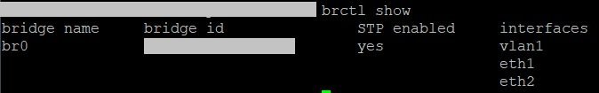

I am running gnuton fork of asusmerlin on my AX3000v2 (AX58v2) in AP mode with AI mesh nodes attached. I have an issue where one lan port degrades from 1gb to 100mb randomly. I can't change the wire or other stuff that might be causing it. I rather just have a script monitor it and reset the connection, like this one.
However, I am having difficulty identifying any of the lan port devices in cli. This is what I get when I do brctl.
