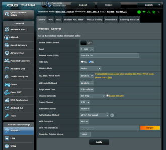

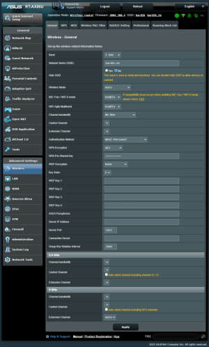

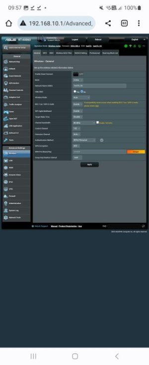

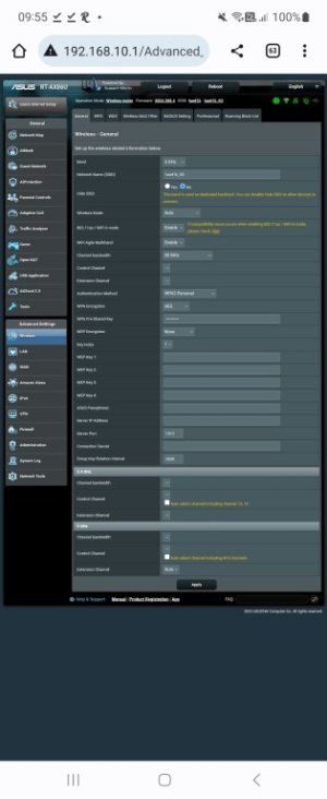

Hello everyone! After buying a new Wi-Fi 6 enabled cellphone, I discovered that it won't connect to the primary Wi-Fi 6 5GHz network (AX86U running on Merlin 3004.388.4 firmware) due to it using Channel 153. When I tried to manually set a different channel, there was just a blank menu with no options for this setting. I thought that it could be due to my going through various firmware updates without restoring factory settings, so I did that. The correct menu settings uppeared, but only before I added my second router (AX92U running on ASUS 3.0.0.4.388_23630 firmware) as an AiMesh node using ethernet backhaul, that's when the wrong functioning returned.
Not only it doesn't preserve the manually set channel that had been selected before the adding of the node, but it reverts back to automatic selection.
Please have a look at the screenshots with and without the AX92U as an AiMesh node.

Welcome to the forums @hard1k.
Those screenshots are too small to read.
What you're seeing are the limitations of using different hardware with different capabilities, together, via AiMesh.
Hello @L&LD, thank you for your reply, it was actually my guess too, just wanted to confirm that there is nothing I can do about it without changing hardware or discarding the AiMesh at all.
Please find attached better screenshots.
