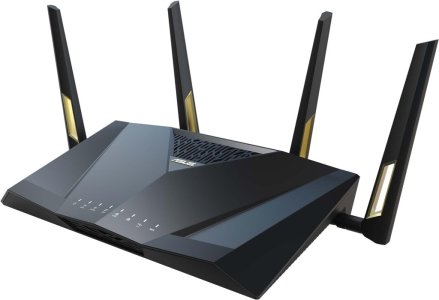

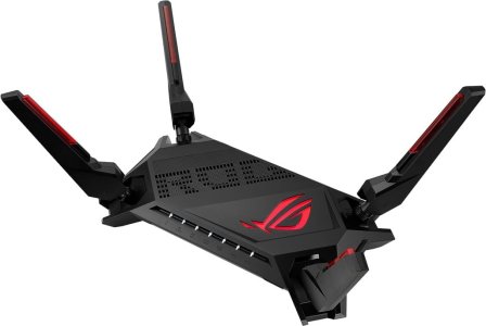

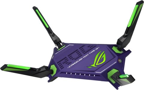

I have this router, with Merlin firmware on it:
ASUS ROG Rapture WiFi 6 AX Gaming Router (GT-AX6000) Dual 2.5G WAN/LAN Ports, Quad-Core 2.0Ghz CPU, WAN Aggregation, AiMesh Compatible, Lifetime Internet Security, Instant Guard, Aura RGB​
$260 now, I think $400 when released?
There is a Hardware Specs Comparison chart not too far down in the article. The GT-AX6000 has very similar hardware to the RT-AX88U Pro--and my AX6000 is by far the best wireless router I have ever had. Covers a 2200+ square foot house with ease. Gamer in the house so it's on his desk hard wired into his PC, some AppleTVs hard wired, then wireless TVs, iPads, iPhones, etc: never a problem. Ever.
I do believe Tech9 recommends the Alien Green version of the GT-AX6000, he likes the subtle color accents and Head Crab Styling. However, we have the more sedate standard version, and have the "Game On" Aura light on top shut off.
Right now the price on the RT-AX88U Pro is very good--get it, flash Merlin on it, enjoy.
PS: I like Dong Ngo's reviews, good info, well organized, fair (I don't think he takes free samples etc).
