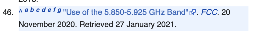

ok Center channels, what I quoted are channels that are authorized in USA. My router is a AX router and should be able to. My router was shipped to me in USA from ASUS, unless BestBuy sold me a router that wasn't. I can buy one directly from ASUS again, I had 2 of the same routers and AiMesh didn't work correctly, so I got my money back.
Picture uploaded, footnote added as well when USA added and authorized use of channels... I also forgot to mention it is UNII3/UNI4 those channels.

Your router model predates those changes. The FCC only released details on the new certification process in September 2021, your model got FCC approval in February 2018. As I said before, you cannot assume that a router that was designed prior to 2018 is capable of operating in another way just because there was a regulation change in one country. Maybe they can and will recertify it, but it will take time and money - it's not just a software fix.
