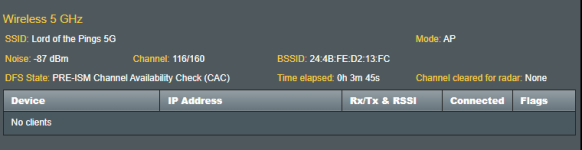

I just tried this. Changed to channel 116 (kept 160mhz) and Log shows:
kernel: CFG80211-ERROR) wl_cfg80211_change_station : WLC_SCB_AUTHORIZE sta_flags_mask not set
Can't even find the 5G network now. Should I select 20/40/80 mhz instead?

That's all normal. You have to wait 10 minutes for the CAC to finish when using DFS channels 120-128 (in the UK/EU).
That's all normal. You have to wait 10 minutes for the CAC to finish when using DFS channels.
But in that case when choosing that specific channel it just didn't work. It kept at that forever. Though it can get radar channels on it's own if I have everything set to auto.
