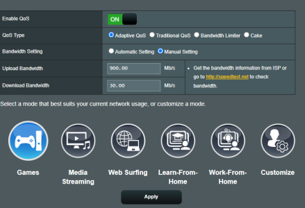

Could you please elaborate? I'm not sure how it could be misconfigured since the only setting I changed from the stock merlin firmware was the QoS setting. I am open to any and all suggestions. Here are the settings I am using for Adaptive QoS, I'm more than happy to be wrong.

Show a screenshot of your QoS settings.
So you have 900Mbps upload and 30Mbps download?
After inputting the correct values for Adaptive QoS it seems to have made a noticeable improvement, but I'm still experiencing noticeable packet loss as well. How can I lower it further?
