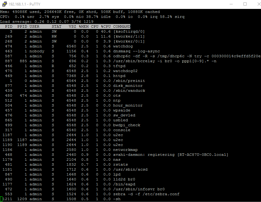

Same here, I'm from Spain, and I have already sent the email for you.
(NAT is activated and no Qos)
CPU 2 has no load
CPU has no load
CPU load is all you can see right of CPU label except "idle" one.
So you have a 61.3% CPU load with a 58.2 used for software irqs
@vanic Sorry for the delay but I'm not able to test or send anything right now. Flu is killing me. Hope to be able to do it in a couple of days
Sorry, I meant that the CPU 2 has no load.
