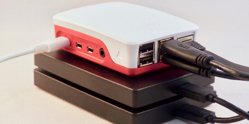

The router's CPU and memory weren't designed to be a NAS, you won't be happy. If you have a Raspberry PI laying around try this instead.

OK, I have tried manually to do it on an RPi4, but failed to get it where I want even trough trying with different PiOS versions and what not....
The video is inspiring, but he is talking too fast so it is VERY hard to follow and also to execute the commands one needs a list of those. Can't even pause the video and read the screen behind him because not all is shown and the video is too low res.
Open Media Vault
After some head scratching and web searches I found this how-to that is text based but a bit too elementary concerning setting up an RPi. But it still gets to the gist of it concerning installing OpenMediaVault on an RPi4.
I now have OMV running on my RPi. It took 17 minutes to run the install script and at the end it looked like it had died while rebooting but it finally got done.
It changed its IP address when booting and that must be because it issued a dhcp release command in the process which meant it got a different IP address on next boot.
Not good, but I had installed my on-boot script that reports the IP address of the RPi on boot so I could find it.
Now remains all that config stuff via the web GUI and here the Youtube video might come in handy.

I used that video to get my RPi NAS up and running and agree, in addition to the video you do need to search the web. The performance is outstanding and I'm able to stream videos without and problem .
