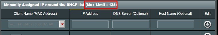

I am using an ASUS GT-AX6000 with the latest Merlin firmware running. I have 131 manually assigned IPs, and many other static IPs on my network. I have three devices that are getting DHCP assignments from the DHCP server that I cannot customize. When I add the IPs to the list of manually assigned IPs, they seem to get listed. But my devices will not give up the initially assigned IP addresses. I have tried reseting the devices themselves but the IPs will either not release, or when I do manage to get them released, the devices get a newly DHCP assigned IP and not the manual one I specified. Also, when I go to the Network Map, find the device and try to manually bind the IP, I get the message "This entry already exists", even if I first remove the manual assignments of those devices. It is like something invisible to me is already reserving those IP addresses and I am unable to release them. I have spent several hours fighting with my network today and completely struck out. These devices had at one time been assigned to other devices, but those devices were re-configured as static IP devices, initially with that IP but subsequently using a different IP. For whatever reason, the IP's I want to reassign are not being released.

Thanks. But how do I locate the cause of the IP's that system says are "in use"? 192.168.1.192, 192.168.1.193 and 192.168.1.194? Best I can tell, no device is using these IPs but the system, wont let me reassign. These IPs were used (by static IP devices) until about 2 weeks ago, when I reassigned their IPs address to numbers in the 180s, and the new device numbers interact fine. I just can't clear the flag that 192.168.1.192, 192.168.1.193 and 192.168.1.194 are in use.

Is there a way to look at my current assignment list, in total? I think I want to examine dnsmasq.conf, but I could be confused.
Just to add, I can look at DHCP leases in the ASUS GUI and these IPs are not listed.
