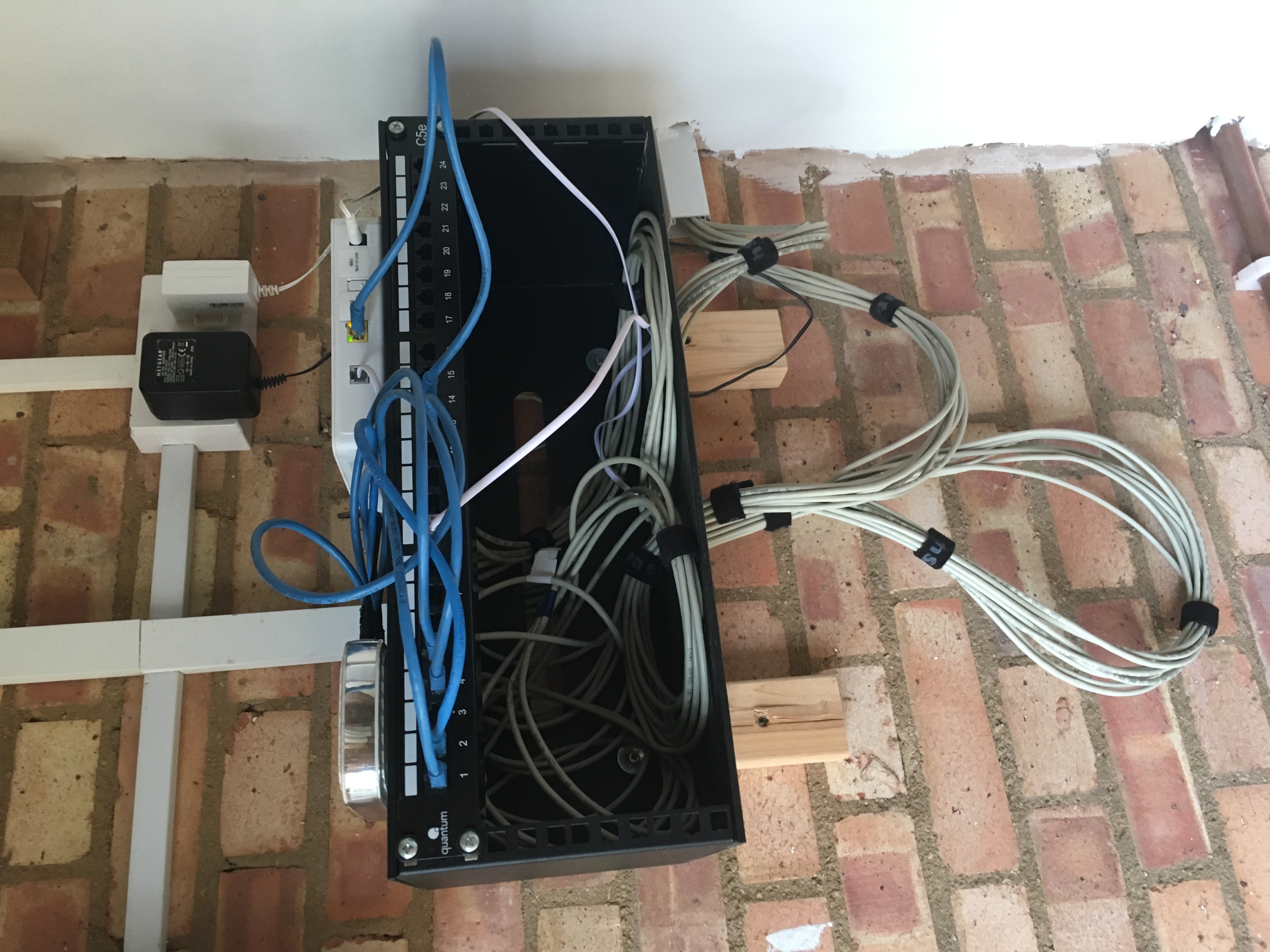

Thanks all for your feedback, all good to know. The reason I was concerned is because of the position of some of the cables, as you can see from the pic below, they're dangling freely so I'm concerned that maybe they should be supported to take the weight off them? Also, the cables exiting the conduit at the right are resting on the relatively sharp edge of the conduit. Is there anything I could or should do to ensure the longevity of the cables?

There shouldn't be any concern if there will be no movement. I would at least use one or two layers of electrical tape where they exit from the conduit. Around the conduit, not on the cables themselves.
If more movement is possible, then consider something that cushions them better still from those sharp edges.
I would also rearrange the cables so that they exit and enter the conduit and box in a much smoother way. Without bending on three axis'. Either move the box over to the left by few inches, push more cable into the box so that it doesn't rest against the conduit, or do a little of both.
But honestly? There doesn't seem to be much wrong with what you have already. :)

Thanks for the tips.
I've got some rubber U channel edging trim that I could use on the conduit box lower edge (I've already used it on the cable entrance to the 4U rack)
I guess I could try pulling the cables that exit from the conduit a bit further into the rack so that they're not dangling so much, but if you don't think the "dangling" cables are an issue then I may just leave them as is.
I think the only way I'll be able to do anyway properly with the very right-most somewhat twisted cable bunch would be to redo the terminations for those cables so that I can rearrange them a bit better, but at the moment I'm loathe to do that unless really necessary.
Johno, I concur with L&LD & Johno. If you're not in an earthquake prone area (in which case, you're going to have greater concerns) as long as no critter or person has access to the area, to chew or tug on the cables, it looks like you meet guy-type wiring codes. If you have room in the floor junction area, I agree with your idea of pulling more of the cable exposed on the floor, into the box.Electrical tape or velcro is your friend if you want to tidy up for strain relief, like is on the grey cable bundle. If the sharp edges of the square conduit or box edge is a worry, a quick/easy fix is fashion a grommet with good quality silcone. A tube of pro 'goo' will fill the space around the cables and cover the sharp edge of the conduit, with the cables in the center, so within a couple of minutes it will seal into a plug, removes moisture and insects from the equation, and can be pulled out/replaced as needed. You can buy special form fitting grommets to fit the conduit, even square, but they're pricey, edging like Johno has is great for box rims. If this is in an area where people will be peering and poking about, a simple box to cover the cables and racks is a lift-off/on remedy I use. I have a form-fitting, natural wood box cover (with small see-through slats on the sides for ventilation) covering a downstairs floor junction much like yours about 2'x2' that doubles as a mid-sized floor spot lamp stand. I tried to tidy it up to meet strict Wife Aesthetic approval codes. I considered slapping a day-glo orange 'Danger-high voltage' sign on the front of it but Wife nixed the proposal, but it would be cheap insurance that most people that saw it would never want to look inside. Anything else would be, well, ridiculous:) Cheers!

Just to keep things stable I think I'll mount a sheet of chipboard or MDF below the rack and behind the cables, then use p-clips to affix the cabling and then add another sheet of wood to protect the cabling.
