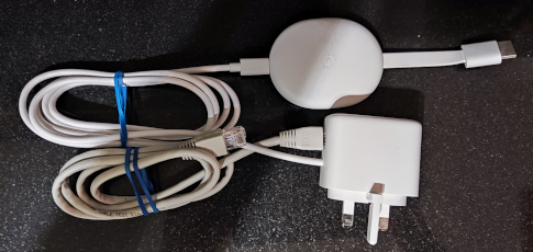

How well Plex can stream files will often depend on how they are encoded! And your Chromecast with Google TV (4K) is not strictly WiFi - I have one here, and you can get a powersupply with ethernet port to replace the PSU it came with - note that it's still limited to 100Mbps though!

Oh yeah, I meant "strictly wifi" in the sense that it's not hard-wired. I have that same adapter and returned it because of the 100mbps

The network ethernet adapter - FWIW - it's been fairly problematic for many - it's fast ethernet only, and has been known to have a level of flake that most folks wouldn't tolerate.
