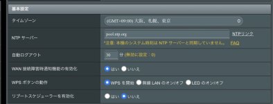

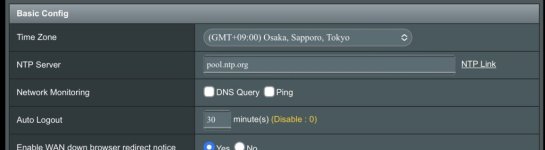

Try disabling Network Monitoring in Administration, System... if it's enabled:
