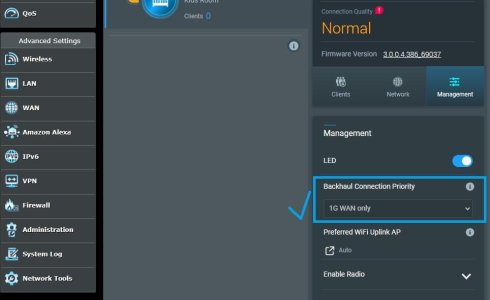

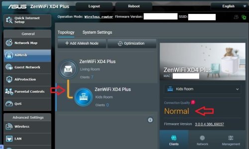

It's been a while since we started to see Wi-Fi connection drops. I logged into Asus router settings and checked AiMesh settings. I realised connection quality is NORMAL instead of EXCELLENT.
I attached the screenshots.
1) Firmware is the latest for router and nod.
2) Backhaul Connection Priority is already set to 1G WAN ONLY
3) Ethernet Backhaul Mode is already enabled.

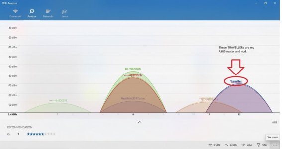

5) I used WIFI Analyzer to see the channels (picture attached).
Could anyone help me understand if my connection drops due to;
1) Ethernet connection "NORMAL" (if yes, how to improve)?
2) Channels? (I used a WI-FI analyzer to see if there is congestion on channels etc. As I see it is also fine (I attached pic).

Investigate your wired backhaul cabling/connectors/ports... should all support Gigabit Ethernet.

Thanks much. All of them are CAT6 even though I don’t need it because I have 250 MBPS internet speed. The problem started not long time ago, so it was working fine. I suspect channels could be guilty and interfere each other in the same channel. but I am not sure if router and mesh mod should be on the same channel or not.
This is a common mistake. Wi-Fi analyzer doesn't show available bandwidth. Only what channels APs around are tuned to. There is a chance the best channel is the one you see as "congested" and the worse no one is using for some local environment reason.

Check what connection you have in Status page in your GUI instead. Not AiMesh page, Status page.

You're radio space doesn't look very congested... confirm your wired backhaul link rates. Check the router Log for clues when you experience connection issues.
I don’t have AP. All were set up as a mesh system.
Do you mean the status under network map?

Check the Ethernet connections physically (cables, connectors), confirm Gigabit connection (Status and AiMesh pages in GUI), test the channels I recommended above and see how it goes. Use 20MHz wide at 2.4GHz and 80MHz wide at 5GHz. You can also see link speeds and signal levels in System Log, Wireless Log pages in GUI. If you still have issues - come back here, describe what's happening. We'll try to help you further. This door is open.
