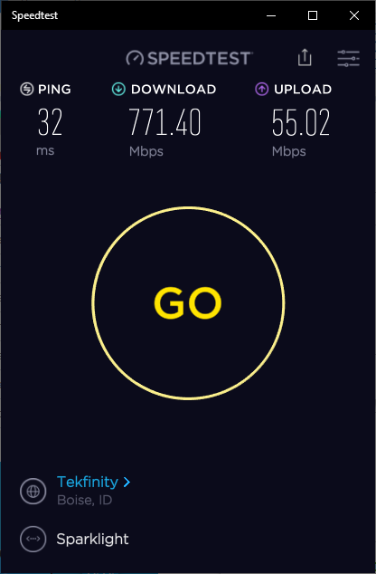

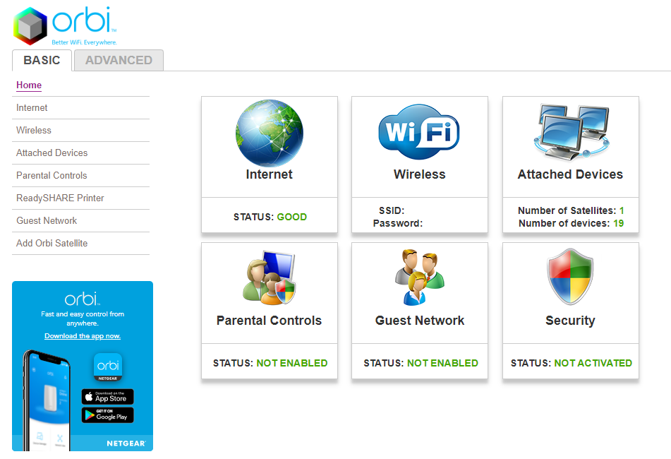

Ok, got my RBK50 system loaded today. Just migrated to Voxels v42 and didn't factory reset anything.
Love the picture icons of course. More modern looking. Easy on the eyes.
First speed test with out a factory reset on the RBR is a bit low: 900/50Mbps ISP
This was with the ISP CM 1100 modem rebooted as well. Possible other factors to slower speed results is that it's a holiday, other people on the line and such. Still not too bad.
I'll try a reset on the RBR at some point.
Gonna do some gaming with two consoles connected and see how things go this week and weekend.

So I was able to reset the RBR50 last night. I'm still not seeing much over 700Mbps after the reset with v42HW loaded. I checked with my RBK852 system that's connected to the other WAN port on the CM1100 and it saw 870Mbps. Though weather conditions last night were snowy and after the ISP came and checked the modem and line about a week ago, that seems to be now the norm, though I had seen over 900Mbps before the tech came out. :mad: He installed a 6db attenuator behind the CM1100. Said some of the signal was too high I guess. I may call the ISP and have them test the line once more and see if we can get back to over 900Mbps...
I might revert back to stock v40 and test again if I get some time this week.
