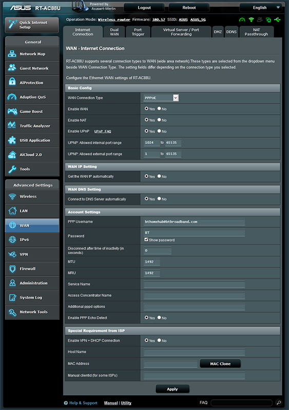

Ever since updating my firmware to Asuswrt-Merlin a few days ago Ive been having disconnection issues. It might just be coincidence, but strangely it seems to occur around midnight and only once! Although this is typically when I am also doing the most downloading/streaming.
The disconnection error message comes up and advises me to run the connection wizard, which I do but it says it cant detect a connection (wired and wirelessly). However if I go turn the MODEM off at the wall for a few seconds and back on then it all connects fine again.
I live in the UK and my ISP is British Telecom (BT) and have the 'Infinity' - fibre optic broadband service. I have a modem provided by them and an Asus RT-AC88U router. I havent altered my settings since the firmware change and have connection type set as PPPoE with a MTU of 1492 as shown below:
Since it occurs at around midnight Im wondering if perhaps theres some sort of time setting thats out of sync or when the dynamic IP changes perhaps??

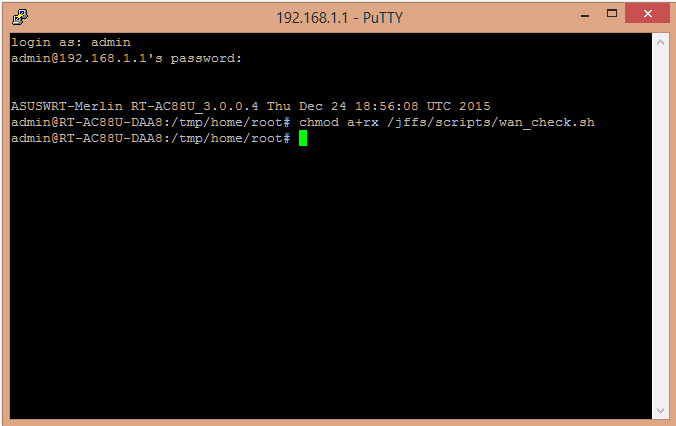

So I downloaded WinScp as suggested and put the wan_check.sh file into the /jffs (and /jffs/scripts) folder. Then loaded up PuTTY and typed in the 'chmod a+rx /jffs/scripts/wan_check.sh' command you said but nothing seemed to happen. Ugh :/

Now you have make it executable with: chmod a+rx /jffs/scripts/wan_check.sh
Then you have to execute script with: /jffs/scripts/wan_check.sh
