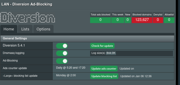

Been a happy Merlin user for many years. First time trying to use Diversion and it is not showing anything blocked and tests show nothing being blocked.
Installed via amtm and default config except I switched to OISD Large
Since I don't even know what correct question to ask, I'll just post my configs and maybe someone can tell me what I am doing wrong?

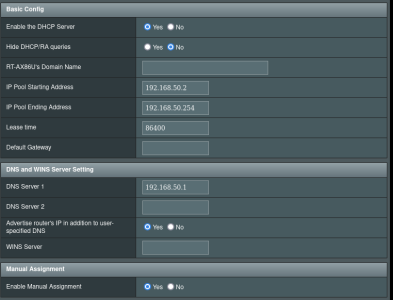

I did not have anything in LAN>DHCP>DNS Server but Diversion instructions said to set that to router IP, so I did. It is not working before or after doing that.

  • Screenshot 2025-01-06 at 13-36-46 ASUS Wireless Router RT-AX86U - DHCP Server.png

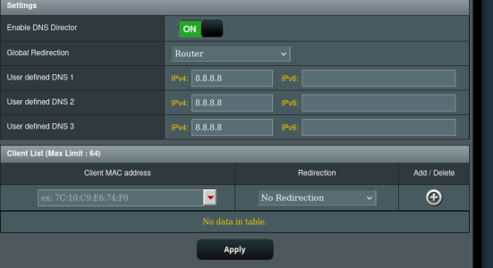

  • Screenshot 2025-01-06 at 13-36-27 ASUS Wireless Router RT-AX86UDNS Director.png

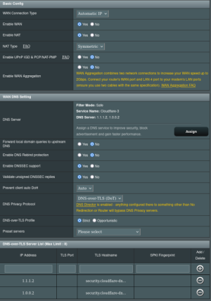

  • Screenshot 2025-01-06 at 13-36-06 ASUS Wireless Router RT-AX86U - Internet Connection.png
1.) Usually the DNS Server 1 & 2 are left blank as this is set by Diversion itself.

How do you know it’s not working? The ad counters only update twice a day.
As noted already, it’s not necessary to set DNS Servers under LAN | DHCP Server. DNS Director settings also not necessary I believe, unless you want to bypass Diversion for select clients.
You can manually ask it to update the blocked ads counter, both from the gui and from the CLI

Some client devices nowadays are defaulting to DNS over HTTPS. This would bypass DNS Director.
I thought the "Prevent client Auto DoH was specifically to prevent that from happening?
Yes, that was the idea. However, I noticed my Apple devices using DoH to Cloudflare while my DoT was Quad9 after an iOS update. I needed to find the settings and disable DoH on each device.
I found the following addresses that are used by Apple to provide DoH & Encrypted DNS.
You need to block the following in Diversion/Skynet or whatever you use.
mask.apple-dns.net
mask.icloud.com
mask-api.icloud.com
mask-h2.icloud.com
doh.dns.apple.com
Please advise if this works as I do not have any Apple kit to try it on !!!
