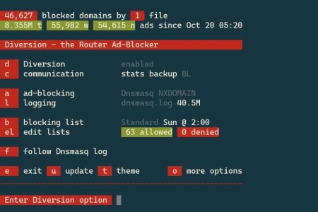

This is an odd issue...you may try uninstalling (make sure you reboot router after uninstaling it) Diversion & reinstalling it again. If the problem persist you might need reset USB/SSD drive. This is how my setup looks:
I go to the amtm->diversion-> adblocking page and press a to enable adblocking, then go test a web page I can confirm its blocking ads. But then if I go back to the amtm->diversion-> adblocking page to check if it shows enabled it shows its disabled, Now if I test a web page at this point ad are allowed.
The a menu is a toggle option turning blocking on and off. You shouldn’t be entering ‘a’ menu item normally. What’s in the system log when you restart Diversion or dnsmasq?
