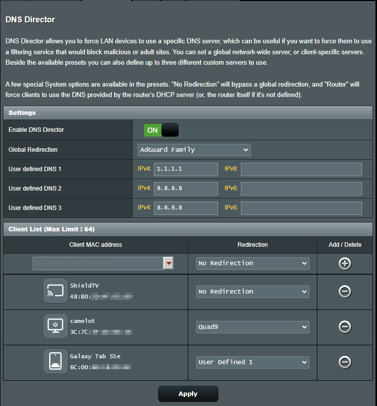

they have their tools...
Yes, it is possible to block to a certain extent with dns 1.1.1.3, but as I said, you can unfortunately bypass it with software, but if you don't

Most likely because your clients go around on-router blocking using different and/or encrypted DNS or VPN/proxy. In order to ensure better blocking efficiency you have to use DNS interception and redirection plus block port 853 (DoT), known DoH servers (additional blocklist) and known VPN/proxy services (additional blocklist). Some private DNS services like iCloud Private Relay use QUIC and you need to block port 80/433 UDP. This will make DPI engine based App traffic recognition better as well, but will slow down Google services using QUIC. Just one blocking method is not enough. Everything above becomes useless if we are talking about mobile device with mobile network access. Android and iOS have built-in parental control on-device.
If you have an RT6600AX, could you please carry out my test?
The test will probably pass/fail depending on the client because of the above. The result is not directly applicable to your clients.
