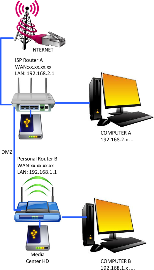

This, I’m sure, is not a unique problem, but I’ve tried a couple of different things that don’t seem to work properly. I’ve drawn a quick diagram to illustrate my current setup:
Here is the problem. I’d like to access, via Samba (Windows share), Router B’s hard drive from Computer A. Computer A can read Router A, and Computer B can read Router A and Router B’s hard drive, but Computer A can’t reach Router B’s hard drive due to a double NAT situation (from what I can understand - this may be wrong though, hence the question asking for advice). Router B used to be the main gateway to the internet but my new ISP requires their modem to be the gateway now. I had DDNS and a VPN set up on Router B. The only way (so far) that I can get those two working now is to enable a DMZ to router B, which makes Computer A unable to connect via Windows Share.

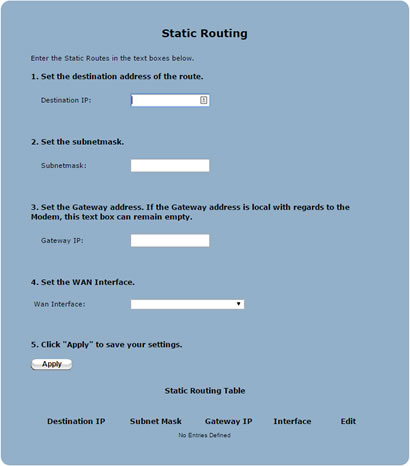

Router A's Static Route Page - I can't enter the external IP of Router B here, so I would have to turn off DMZ first, or use 192.168.1.1?
I'm confused on where DMZ is enabled and to what IP.
How is Router B's WAN port connected? You should the WAN IP as XXX.XXX.XXX.XXX
Add the routes on the blue router.. If the router really supports static routes try Destination IP: 0.0.0.0 Subnet mask: 0.0.0.0 Gateway IP: 192.168.2.1. That statement says: For Any ip any subnet go to 192.168.2.1
thiggins: The DMZ is turned on Router A through a feature called "Advanced DMZ" in the router's settings. You set the MAC address of Router B and then Router B gets an external IP instead of an internal IP of 192.168.2.xx. Then Router B is basically connected as if there wasn't a router A at all. Except for the fact that Computer A can no longer read the media server on Router B because it is outside of the "loop". Router B has the external WAN IP and is coming in on the WAN port leaving the 4 LAN ports available. Hope that makes sense.
netwrks: I'll try to enter the static routes when I get home. Computers hooked to Router B can connect to both Router A & B no problem. It's just going from Computer A backwards to Router B that doesn't work. Would this expose my internal network to the Internet? Confused - sorry :)
Thanks!
Ok.. RE: DMZ addressing. In your current configuration, it sounds like you are already exposed to the Internet, by using the DMZ feature. with an external IP address.
The "Advanced DMZ" sounds like transparent bridging, if Router B is getting a routable WAN IP address. So both routers have public IP addresses?
Why is anything connected to Router A anyway? How is Router A acting as a "gateway" if Router B is connected directly to the internet?
That SAMBA server - is it running on the Router B or is it running on the MediaCenter HD attached to Router B - USB or Ethernet?
sfx2000: The SAMBA server is running on Router B attached via USB. It is a 1TB USB3.0 drive attached to an ASUS RT N66U router with a share name of \\SERVER
thiggins: There is an option for an "Enhanced Bridge Mode" as well, but I've only enabled the "Advanced DMZ". Both Router A and Router B seem to have the same external WAN IP address. I can't remove Router A as it is required for the FibreOp line coming in on VLAN35 (or something like that). It is a Bell FibreOp 3.0 install and Router A is an ActionTec R3000 which is an AC router.
