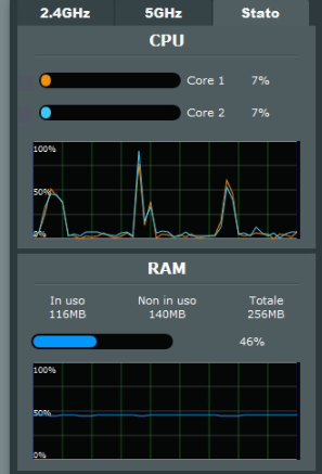

I've got the latest gnuton installed,my cpu temp is showing as 82C is that ok ?
Room temp 20c,also how do I go about installing scripts?
I want to install the Jfresh script (I've posted in that thread too) but wasn't sure if i need to do anything different because it's not the ordinary merlin firmware.
This is the firmware I installed,I hope this was the right one https://github.com/gnuton/asuswrt-merlin.ng/releases
everything will be same as with Merlin firmware, only DSL-part included.
82 is hot but seems to be in most upper range for DSL-AC68U. Silent fan on backside (5V from USB) could easily bring it down below 70 where all components would be happy about.
So I've installed the correct one then and those temps are normal for custom firmware?
Those temps are without any load btw,cpu cores 3% max
