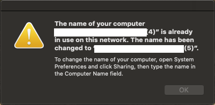

A few weeks ago I started getting this weird msg on my Mac saying that my computer name was already in use. What I didn't realize at that time is that this was impacting all my Apple devices (Mac, iPhone, iPad and HomePod).
After digging into the internet, I couldn't find much. While I am not sure this is related to my router, I was hoping someone would have an idea.
While my initial hypothesis was: this is happening because my Mac is connected to the internet via Wifi + Ethernet. That is not true when you look at my other Apple devices (in which I get the same behaviour).
