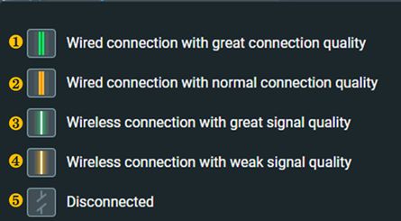

Legend of what the different colors mean:
